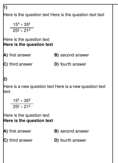

I think this meets your requirements.
b
I changed the definition of \Startex. You have to use as \Startex{<text of the question>}. All the text of the question will be left justified.
Also added the configuration of the tasks, to get the uppercase, the bold face and the left margin.
% !TeX TS-program = pdflatex
\documentclass[a4paper]{article} \usepackage[margin=1.5cm]{geometry} \usepackage{helvet} \renewcommand\familydefault{\sfdefault} \usepackage{mathastext} \usepackage{tasks} \usepackage{multicol} \usepackage{lastpage} \usepackage{pgfplots,relsize} \usetikzlibrary{shapes.symbols} \usepackage{ragged2e} \usepgfplotslibrary{fillbetween} \usepackage{fancyhdr} \usepackage{amsmath} \makeatletter \newcommand\myfrac[2]{\frac{;;#1;;}{;;#2;;}} \makeatother \usetikzlibrary{calc}
\pagestyle{fancy} \fancyhf{} \renewcommand{\headrulewidth}{0pt} \newcounter{numex}
\setlength{\columnseprule}{1pt} \setlength{\columnsep}{1.2cm}
%%****************** \newcommand{\Startex}[1]{% changed <<<<<<<<<<<<<<<<<<<<< \noindent \parbox[t]{\columnwidth}{% \stepcounter{numex} \setlength{\parskip}{0pt} \textbf{\thenumex)}\vspace*{0.2cm}
#1} }
\newlength{\taskindent} \settowidth{\taskindent}{\textbf{m)}} \settasks{% added <<<<<<<<<< item-indent=\taskindent, % align with margin <<<<<<<<<<< label-format = \bfseries\MakeUppercase, % format labels <<<<<<<<<< after-skip = 3ex, % space after the list }
\newcommand{\thickfrac}[2]{\genfrac{}{}{0.9pt}{0}{#1}{#2}} \newcommand\bigfrac[3][2.0pt]{% {\thickfrac{\hspace{#1}#2\hspace{#1}}{\hspace{#1}#3\hspace{#1}}}}
\let\oldfrac\frac \let\frac\bigfrac % \usepackage{MnSymbol}
\usepackage{showframe} % only to show the margin <<<<<<<<<<
\begin{document} \begin{multicols*}{2}
\Startex{% Here is the question text Here is the question text text \bigskip
    \hspace{0.5cm}$\myfrac{15^x+ 35^y}{25^y+21^z}$
    \bigskip
    \textbf{Here is the question text}
        \begin{tasks}(2)
            \task first answer
            \task second answer
            \task third answer
            \task fourth answer
        \end{tasks}
\Startex{% new question &lt;&lt;&lt;&lt;&lt;
    Here is a new question text Here is a new question text text
    \bigskip
    \bigskip
\begin{tasks}(2)
    \task first answer
    \task second answer
    \task third answer
    \task fourth answer
\end{tasks}
\end{multicols*} \end{document}
