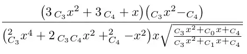

\documentclass{article}
\begin{document}
\frac{{\left(3 \, _{C_{3}} x^{2} + 3 \, _{C_{4}} + x\right)}
{\left(_{C_{3}} x^{2} - _{C_{4}}\right)}}{{\left(_{C_{3}}^{2} x^{4} +
2 \, _{C_{3}} {_{C_{4}}} x^{2} + _{C_{4}}^{2} - x^{2}\right)} x
\sqrt{\frac{_{C_{3}} x^{2} + _{C_{0}} x + _{C_{4}}}{_{C_{3}} x^{2} +
_{C_{1}} x + _{C_{4}}}}}
\end{document}
The OP indicates that the input was also autogenerated. My point, however, is that someone, somewhere, chose to use underscores as part of variable names. That was the big mistake .
If you were able to make sagetex convert all underscores in variable names to \_ when converting to LaTeX, the output would at least make sense at that point, though I still find the presence of the underscores unnatural. This would be more of a feature request rather than a bug report.
