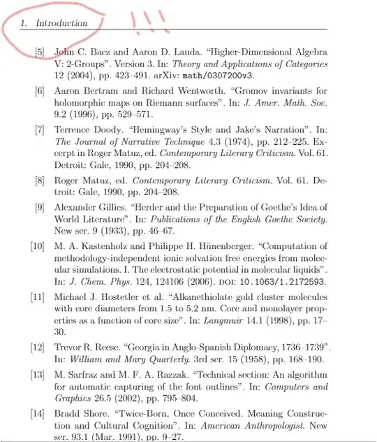

I want to have Bibliography as a header title in my bibliography (starting obviously from the second page). But, the title of the previous chapters appears instead!
I am using Memoir class with biblatex. with my pagestyle named as: MyPageStyle
Here is my MWE

here is a snapshot of my problem
Any idea on how to solve that?

  • Under oneside you should use \rightmark instead. For example the standard memoir headings style only writes to \rightmark under oneside. Looking at biblatex.def this is exactly what biblatex does under oneside – daleif Jun 16 '21 at 11:12
Under oneside you should use \rightmark as this is what most header data providers only write to under oneside.
For the added question:
Not many of the page styles have a oneside and a twoside variant. The default headings does. The style ruled does not. Meaning that \chapter will only write to \leftmark. IMO the default for \chapter should be to write to both (which I normally do in all of my own documents). It is too late to change this now.
Here is how to add bothness:
\addtopsmarks{MyPageStyle}{}{
  \createmark{chapter}{both}{shownumber}{}{. \space}
add it somewhere after \copypagestyle{MyPageStyle}{ruled} and before \pagestyle{MyPageStyle}
