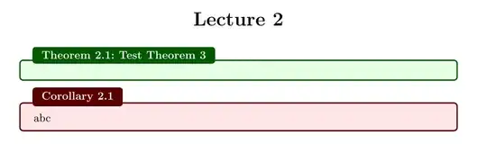

EDIT: I got some resemblence of what I want working as you can see, by adding to the \newdocumentenvironment part a \addcontentsline which references the environment name and its optional title. The current issues are: Not being able to display the envionment number (like Theorem 1.1) and not including a colon if the environment does not have a title (like in the second theorem).
enter image description here enter image description here enter image description here
