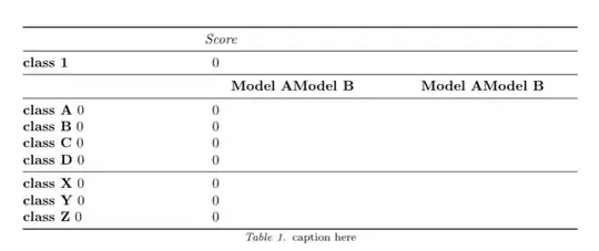

I tried using the following code, with an unexpected outcome shown below (I've also attached the outcome I am expecting):
\documentclass{article}
\usepackage{siunitx} \usepackage{array,booktabs}
\begin{document} \begin{table}
\begin{tabular*}{\textwidth}{@{\extracolsep{\fill}}lSS@{}} \\\toprule
&{\textit{Score}}\\\midrule
    \textbf{class 1}  & 0 \\
    \midrule
    &\multicolumn{2}{cc}{\textbf{Model A}\textbf{Model B}}\\
    \midrule
    \textbf{class A}   0  &  0\\
    \textbf{class B}  0  &  0\\
    \textbf{class C}  0  &  0\\
    \textbf{class D}  0  &  0\\
    \midrule
    \textbf{class X}  0  &  0\\
    \textbf{class Y}  0  &  0\\
    \textbf{class Z}  0  &  0\\
    \bottomrule
\end{tabular*}
\caption{caption here}
\label{table:results}
\end{table}
\end{document}
This has three major issues shown below: (1) the alignment of "Score" should be centered, (2) Model A Model B are repeating, and (3) the 0 values are shifted towards the left
I am trying to get an output which looks like:

  • Did you notice the error message "Package array Error: Only one column-spec. allowed.." that you get upon compiling the code? Please never ever ignore error messages! Even if you get something that on first glance resembles a pdf file, there can still be issues with it. After an error, TeX only tries to recover enough to syntax check more of the file, it does not try to make sensible output after an error. To summarize: fix all error messages before even looking at the output. – leandriis Feb 21 '21 at 20:12
  • Is there a reason for stretching the table to textwidth? Since the contents of all columns are quite narrow, stretching the table just makes it harder to read. Wouldn't a regular \begin{tabular}{@{}lSS@{}} be sufficient? – leandriis Feb 21 '21 at 20:14
