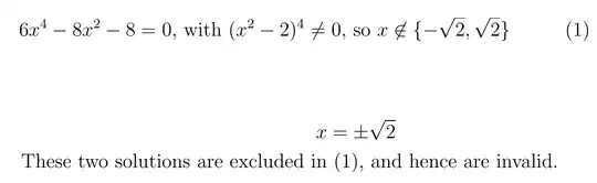

This gives the following output: enter image description here Neither the \label or the \eqref (I also tried \ref with the same result) worked.
Is there any way to label that line and add a hyperlink to it where the (??) are? I want it to look like this: enter image description here With the (1) at the bottom being a hyperlink to the equation numbered 1. I used the following to get the above image:

    Maybe the problem is the star in align. Try \begin{align}...\end{align} without the star – Luis Turcio Feb 04 '21 at 03:30
  • @Luis But won't this cause all the equations to be numbered? I only want that one to be numbered. – Just_A_User Feb 04 '21 at 03:36
  • You can use \tag with align* or \notag with align, but you need a \label for \ref. This is assuming you put more than one equation into align or align*. – John Kormylo Feb 04 '21 at 05:13
There's a lot wrong here, but you can't do an \eqref to a non-numbered equation. Using an align instead of align* will fix that problem. But then, you're also not aligning anything so why use an align at all?
The minipage concerns me because it serves no purpose that I can see, and the use of \text inside the second align* is dubious at best and I would put the text outside the align. Overall, I think that the document would be better generated by writing:

A general remark up front: To create cross-references (to equations, or to any other object linked a counter variable) in a LaTeX document, one needs both a \label statement -- if you do things correctly, LaTeX will associate the argument of \label with the object's counter -- and a \ref (or \eqref, \autoref, \cref, etc) directive to generate the cross-referencing call-out. A \tag statement isn't a substitute for a \label statement.
Here's a variation on @DonHosek's answer. It attempts to streamline and simplify your somewhat complex code while (hopefully) also making the exposition of the argument easier to follow. Observe that by using \label{eq:quartic}, I try to provide a hint at the meaning of the object (here: an equation).
