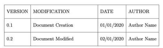

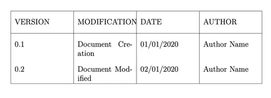

The result is the following (As you can see no \hline on the table is added):
When I try to add an \hline anywhere I get a compilation error. How I can add an \hline (or alternative) to every row appended using my macro?

Change your macro \addrevision into
\newcommand\addrevision[4]{%
    \appendrevision{#1 & #2 & #3 & #4 \\[10pt] \protect\hline}
and remove the trailing \hline in the definition of \revisions
\newcommand{\revisions}{
  \begin{center}
  \setlength{\extrarowheight}{10pt}
  \begin{tabularx}{\textwidth}{| l | X | l | l |}
  \hline
  VERSION & MODIFICATION & DATE & AUTHOR \\[10pt]
  \hline
  \revisionrows
  \end{tabularx}
  \end{center}
I'd use a single X column, for the one with possible long data.
