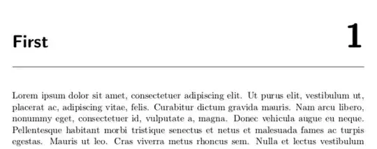

I would like to display on the first page of every chapter, the chapter's name, followed by some spacing and then the chapter's number in big numerals. It should look something like the following, except in black or dark grey. My problem is, that I found a few solutions, but they are all with titlesec, but I'm using fancyhdr and it doesn't seem to be compatible. And I'm using scrreprt and can't switch to memoir. And it's also important that only the chapters are affected and not table of contents or list of figures.
I really like this example, but I don't understand how to make the number look different (more like the one in the picture) and how tho align the number with the paragraph. enter image description here

Here is a suggestion based on the code linked in the question:

Improved answer
\documentclass[chapterprefix=off]{scrreprt}
\usepackage{lipsum} \usepackage{anyfontsize} \newcommand{\HUGE}{\fontsize{40}{44pt}\selectfont}
\renewcommand{\chapterlinesformat}[3] {\mbox{#3}\hfill\HUGE{\mbox{\thechapter}}\[10pt] \hrulefill }
\begin{document} \chapter{First}
\lipsum
\end{document}
Below is the original answer that did not address the question. I just leave it in for reference.
