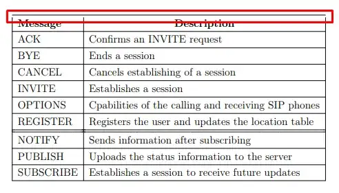

I created a table, where I wanted a double horizontal line, so I used \hhline

what caused vertical lines on top of my table to disconnect from very top horizontal line:
Disconnected lines
is there any way to fix this, please? Thank you in advance for your help.
Sam
    Welcome to TeX.SE! Your code fragment doesn't reproduce your problem. Top \hline is probably \toprule or \midrule (I guessing). – Zarko Nov 18 '20 at 03:20
  • as Zarko says your fragment (if we guess a surrounding document as you have not provided one) does not have this issue, your top rule is \hline not \hhline in any case so the question is not about \hhline as mentioned in the title. You do not need \hhline at all here your double rule could more simply be coded as \hline\hline. Please edit the question to make a complete small document that generates the image shown. – David Carlisle Nov 18 '20 at 07:46
  • Based on comments I found out, that it wasn't really caused by \hhline. I thought so, because it showed that way after adding \hhline (I don't want to use \hline\hline, because it makes something slightly different). My problem was caused by using package "arydshln" - at least everything works fine without using it. Thank you very much for your help, it helped me a lot. – Sam Nov 18 '20 at 17:27
