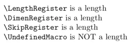

\NewDocumentCommand{\IfLengthTF}{mmm}
  \lentest_if_length:NTF #1 { #2 } { #3 }
\NewDocumentCommand{\IfLengthF}{mm}
  \lentest_if_length:NF #1 { #2 }
\NewDocumentCommand{\IfLengthT}{mm}
  \lentest_if_length:NT #1 { #2 }
\prg_new_protected_conditional:Npnn \lentest_if_length:N #1 {p,T,F,TF}
  \regex_match:nxTF {\A\\??(skip|dimen).+} { \token_to_meaning:N #1 }
   { \prg_return_true: }
   { \prg_return_false: }
\cs_generate_variant:Nn \regex_match:nnTF {nx}
\ExplSyntaxOff
\newlength\pippo
\newdimen\pluto
\IfLengthTF{\pippo}{\typeout{It's a length}}{\typeout{It's NOT a length}}
\IfLengthTF{\pluto}{\typeout{It's a length}}{\typeout{It's NOT a length}}
\IfLengthTF{\skip}{\typeout{It's a length}}{\typeout{It's NOT a length}}
\IfLengthTF{\xxeey}{\typeout{It's a length}}{\typeout{It's NOT a length}}
The output is
It's a length
It's a length
It's NOT a length
It's NOT a length
One can also use \IfLengthT or \IfLengthF, when the true or false branches are not needed.

This now available with the etoolbox package with \ifdefdimen and \ifdeflength:
Code:
\documentclass{article}
\usepackage{etoolbox}
\newcommand*{\IfLengthTF}[3]{% {\ttfamily\string#1} \ifdefdimen{#1}{#2}{% \ifdeflength{#1}{#2}{#3}% }% }
\newlength\LengthRegister \newdimen\DimenRegister \newskip\SkipRegister
\begin{document} \IfLengthTF{\LengthRegister}{is a length}{is NOT a length}\par \IfLengthTF{\DimenRegister}{is a length}{is NOT a length}\par \IfLengthTF{\SkipRegister}{is a length}{is NOT a length}\par \IfLengthTF{\UndefinedMacro}{is a length}{is NOT a length}\par \end{document}
Peter Grill
  • 223,288
  • Just wondering, do you really need expl3 for the cs to string, wouldn't \string#1 be enough? (untested, not at pc) – daleif Mar 29 '18 at 07:27
  • @daleif: I tried that and it was inserting a " before the name. – Peter Grill Mar 29 '18 at 07:30
    @PeterGrill That has to do with font encoding. If you use \ttfamily it will print \ , and if you load \usepackage[T1]{fontenc} it will show also the backslash. – Manuel Mar 29 '18 at 07:32
