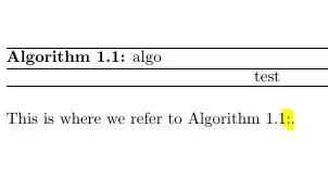

This is a follow-up question from Solution (2) of this answer. I wanted to have a : after the algorithm number and before the algorithm caption. To do that, I added : with the solution. It (somehow) works. However, the problem is that this : appears everytime I refer to the algorithm.
See this minimal working example with the corresponding output (highlighted):

\chapter{chapter1} \begin{algorithm}[H] \centering test \caption{algo} \label{algo1} \end{algorithm}
This where we refer to Algorithm \ref{algo1}. \end{document}
So, I appreciate your help to remove this unwanted : from the place I refer to the algorithm.

Try with caption package as shown here:
\documentclass[11pt]{book}
\usepackage[ruled,vlined,linesnumbered,algo2e,resetcount,algochapter]{algorithm2e}
\usepackage{algorithm}
\usepackage{caption}
\captionsetup[algorithm]{labelsep=colon}
%Edit: \usepackage{chngcntr} %Comment that out for newer versions of LaTeX \counterwithin{algorithm}{chapter}
\begin{document}
This is where we refer to Algorithm \ref{algo1}. \end{document}
