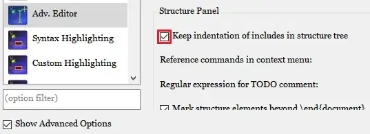

  1. Go to Options -> Configure TeXstudio...,
  2. check Show Advanced Options in the bottom left corner,
  3. go to Adv. Editor,
  4. under Structure Panel check Keep indentation of includes in structure tree.
Check this box in the settings
Note: you may have to restart TeXstudio for this to take affect
