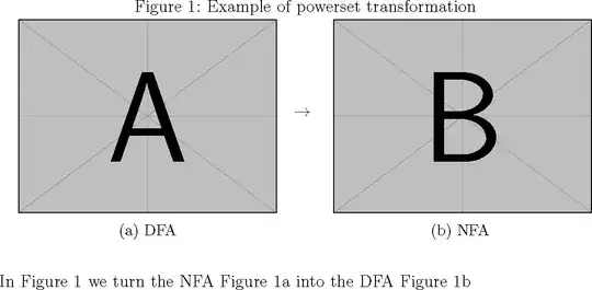

At first I thought this was peculiar to figures, but it also affects tables. I guess it is a subfig bug which was preserved in subcaption.
One solution is to play with the figure counter, but I prefer to use saveboxes.
BTW, there is no align option for \includegraphics. Instead one can use \raisebox, but subfig and subcaption require different solutions.
\documentclass[12pt,a4paper]{scrartcl}
\usepackage{graphicx}
\usepackage{subcaption}
\usepackage{hyperref}
\usepackage{cleveref}
\begin{document}
\begin{figure}%
    \sbox0{\subfloat[DFA\label{subfig:powerset_nfa}] {%
        \includegraphics[width=0.4\textwidth]{example-image-a}%
    \sbox1{\subfloat[NFA] {% works either way
        \label{subfig:powerset_dfa}
        \includegraphics[width=0.4\textwidth]{example-image-b}%
    \centering
    \captionsetup[figure]{position=top}%
    \caption{Example of powerset transformation}%
    \label{fig:powerset_ex}
    \raisebox{-0.5\height}{\usebox0}
    ~ $\rightarrow$ ~
    \raisebox{-0.5\height}{\usebox1}
\end{figure}
In \Cref{fig:powerset_ex} we turn the NFA \Cref{subfig:powerset_nfa} into the DFA \Cref{subfig:powerset_dfa}
\end{document}
demo

  • Thanks, works perferctly. Btw I used align via the adjustbox package, just deleted it in the preamble when extracting the MWE. Result is the same as with raisebox then. – PattuX Mar 30 '20 at 16:33
