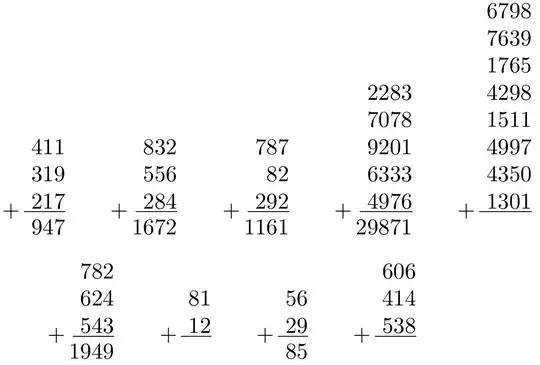

Inspired from this answer I would like to generate a multi-digit addend using some random numbers.
I can generate the random numbers, but I'm unable to use them properly (Tex capacity exceeded). Here is my MWE:

    The big problem here is that \random is not expandable. The other problem is that, even if it were expandable, you would have to expand it for \showsum by way of \expandafter\showsum\expandafter{\expanded{\random}} – Steven B. Segletes Feb 08 '20 at 18:45
  • hmmm, so a better approach would be using another random generator package (pgf for example)? – lAtExFaN Feb 08 '20 at 18:54
  • I don't work with random numbers in LaTeX, but you would need to be able to do something like \edef\tmp{\random} and then \expandafter\showsum\expandafter{\tmp}. – Steven B. Segletes Feb 08 '20 at 18:57
  • Another approach would be to write the random numbers to a file and then read them back in. – Steven B. Segletes Feb 08 '20 at 18:58
As said by @StevenB.Segletes, \rand isn't expandable, therefore one can't record the produced random numbers in a macro simply using this function. For the same reason, even if \showsum were trying to recursively expand your \random, it wouldn't be able to get anything useful from it—and this wouldn't be better if you passed it directly the argument \rand\arabic{rand} \rand\arabic{rand} \rand\arabic{rand}, which is only one expansion step away from your \random.
In order to solve this, I propose to use the \int_rand:nn function from expl3, which does produce random integers in an expandable manner (the bounds provided as arguments are both included in the possible results). Moreover, I'll wrap this up so that for instance, calling \myrandsums{5}{1000}{9999} prints a sum of five random integers n for which 1000 ≤ n ≤ 9999.

Sample output:
The following is a slightly more elaborate variant. It provides a \myrandsums function that behaves the same as above, and additionally \myRandsums that ignores the current contents of \showsums:

Sample output:
frougon
  • 24,283
  • 55
  • thanks a lot @frougon - it works nice. And some day I'll hopefully also understand why ... ;-) – lAtExFaN Feb 08 '20 at 21:21
  • You're welcome. I added a slightly more elaborate version that provides 1) an equivalent \myrandsums function and 2) a new \myRandsums that prints the result if, and only if you use its starred form. If you want to understand all this, you can 1) Read the TeXbook until chap. 20 (macros), possibly skipping math typesetting; 2) Practice macro programming (you can treat problems like this question in plain TeX). 3) Read expl3.pdf and chosen parts of interface3.pdf from l3kernel. Happy TeXing! :-) – frougon Feb 09 '20 at 00:30

  • thanks @egreg, less dependencies are of course preferable. One small note: Compared to frougon's answer the alignment is not so nice (I use two for-loops to generate a sheet and the lined tables seem to have different width) Code: \large \foreach \i in {1,...,12}{% \noindent \foreach \j in {1,...,6}{% \randomsum*{3}{1}{999} } } – lAtExFaN Feb 09 '20 at 09:35
  • workaround: placed the tabular into a parbox with fixed width – lAtExFaN Feb 09 '20 at 10:54
  • @lAtExFaN The widths are different to cope with different width of the summands and the total. – egreg Feb 09 '20 at 14:16
