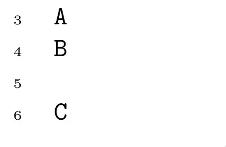

You can even specify at which number the numbering should begin, with
\begin{minted}[linenos, firstnumber=3]{text}
A
B
C
\end{minted}
which will produce
