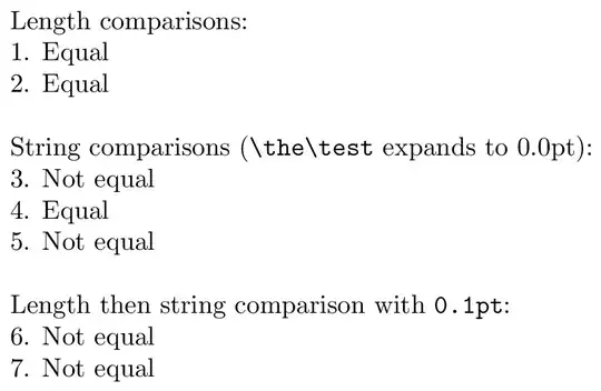

And finally, the promised examples with the ifthen package:
\documentclass{article}
\usepackage{ifthen}
\newlength{\test} \setlength{\parindent}{0pt}
\begin{document}
\setlength{\test}{0pt} Length comparisons:\
  1. \ifthenelse{\lengthtest{\test=0.0pt}}{Equal}{Not equal}\
  2. \ifthenelse{\lengthtest{\test=0pt}}{Equal}{Not equal}
\bigskip String comparisons (\verb|\the\test| expands to \the\test):\ 3. \ifthenelse{\equal{\the\test}{0.0pt}}{Equal}{Not equal}\ 4. \ifthenelse{\equal{\the\test}{\detokenize{0.0pt}}}{Equal}{Not equal}\ 5. \ifthenelse{\equal{\the\test}{\detokenize{0pt}}}{Equal}{Not equal}
\bigskip \setlength{\test}{0.1pt} Length then string comparison with \verb|0.1pt|:\ 6. \ifthenelse{\lengthtest{\test=0.0pt}}{Equal}{Not equal}\ 7. \ifthenelse{\equal{\the\test}{0.0pt}}{Equal}{Not equal}
\end{document}
examples with ifthen
