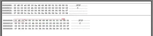

I wish to annotate a hex text block with matrix. and the matrix output should be similar to listings output. so I add a listings above for compare.

How can I adjust the parameters to get similar result between matrix output and listings output? Or any other choice for such annotation purpose? enter image description here

Like this?
screenshot

refer to this SO, I modify it with hardcode hex numbers. it's a little bit long but now sure if any regrex support for listings keyword define! Maybe someone can help improve it.

Now it looks like: enter image description here
