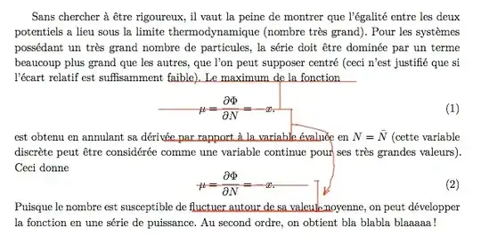

Here's a preview of my vertical spacing problem:
As you can see on this picture, the vertical spacing above and under equations is variable. I hate that! I want a perfectly constant spacing for all equations, above and under the text. When I comment out the \setlength commands in this MWE, I could get a much better display, but still it isn't perfect. Depending on the text and equations, I may get some variable spacing. So I have two questions:
  1. How can I absolutly fix the vertical spacing above and under each equation?
  2. What should be a natural spacing value? I used 8pt in that MWE example, but it needs to be scalable if I decide to change the global font size. I don't know what should be the proper space.
Please, take note that I'm not asking about the shortskip of equation (2) in this example, which is fine. Just see the three thin vertical red lines I've draw on the picture.

    You forget there are optical illusions. Your equation (2) use \abovedisplayshortskip because the line above the equation is very short, so that it is the last but one line above which is important to the eye. If you use \abovedisplay skip w.r.t. the last line, the spacing w.r.t. the previous line will be too large. – Bernard Dec 09 '19 at 23:06
  • @Bernard, I'm not talking about the shortskip, which is natural here. This isn't what I want to change. Just see the vertical red lines I've drawn in my preview picture. – Cham Dec 09 '19 at 23:08

  • your lines are highlighting spaces that tex doesn't usually track at all, base of one row of text to top of the next, tex tries to maintain baseline to baseline spacing mostly. You are marking the x-height of a run of letters that happen not to have any capitals on the line below the equation, tex has no information at all about that internally, it bases the spacing on the hbox that contains the entire line – David Carlisle Dec 10 '19 at 00:48

With the new uploaded image the two lengths marked by the arrow differ because of user settings. The first is based on \belowdisplayskip and the second (as the line above the display is short) uses \belowdisplayshortskip. If you want the spaces to be equal just set these to the same value, eg
\setlength\belowdisplayshortskip{\belowdisplayskip}
would make them both use the value from the first equation.
