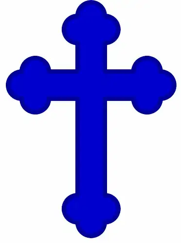

From the answer to this and this questions;
I used the following code to draw a cross.

Is it possible to modify one part of the \foreach loop to produce the following drawings.

Absolutely. You only need to use \ifnum. This works especially smoothly when you use the shortened \edge from my previous answer, which avoids unnecessary repetition. In more detail, let's define
\def\edge{
(.5,.5) -- ++ \ifnum\i=180 (0,2.5) \else (0,1.05)\fi
foreach \j in {0,90,180}  {to [out=\j,in=\j,looseness=1.6] ++ (\j+90:1)}
Here you see that if \i equals 180, there will be a line of length 2.5 whereas for all other \i it is 1.05 units long.

And
