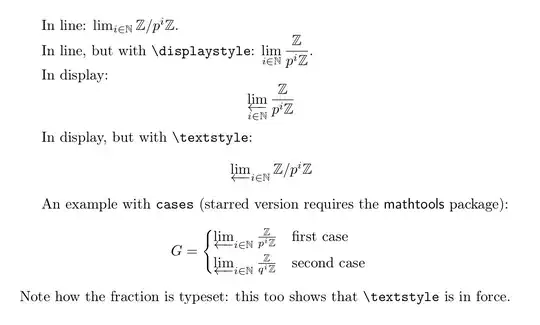

It’s not clear what you want to do when you explicitly reset the math style. The following solution, which requires amsmath but works also with the “classical” typesetting engines, discriminates based on the \if@display switch. This purposely ignores the math style (\displaystyle vs. other styles), and decides which command to use (\varprojlim vs. \lim) considering only if the formula is being displayed or typeset in-line.
I insist that it is not clear from your question whether you consider this a bug or a feature. See also @daleif’s comment.

The printout:
Output of the code
GuM
  • 21,558
  • +1 but there is a point you might want to clarify: \if@display won't work with something like $\displaystyle...$. Just to be thorough. – campa Oct 18 '19 at 10:28
  • @campa: Thank you for your suggestion; please see edit. – GuM Oct 18 '19 at 22:35
