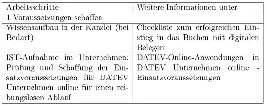

Texmaker will give me a lot of warnings:
Underfull \hbox (badness xxxxx) in paragraph at lines xx--xx
My code looks like this.

The table looks like this:
In my original file the table is much longer and I will only get warnings for rows where one cell have more rows than the other one.
How can I get rid of the warnings?

    The underfull box warning are caused by the table columns being justified. To overcome this and to left align the contents of the longtable instead of justifying them, you could use \begin{longtable}{|>{\raggedright\arraybackslash}p{0.45\textwidth}|>{\raggedright\arraybackslash}p{0.45\textwidth}| } and add the array package to your preamble. – leandriis Oct 15 '19 at 18:44
  • Thank you very much, it has gotten much better. I followed your instructions and now get only 1 warning "Underfull \vbox (badness 10000) detected at line 24 (thats the line "\end{longtable}"). Do you also know how i can get rid of this error?
    I think it is related to biber because the warnings only gets shown if I configure Texmaker to use biber insted of bibtex
    – Christian Oct 15 '19 at 18:57
  • @Christian: Your curent example code contains nothing that would require the use of biber so I don't really get it. What happens if you just use pdflatex to compile your code? – leandriis Oct 15 '19 at 19:07
  • Well, you're right I've tested it again and saw that the warning just got covered under an other error - sorry I've edited my main post now... – Christian Oct 15 '19 at 19:19
  • @Christian: We'd like to keep answers separate from questions, so please write a separate answer instead of editing your answer into the question. – leandriis Oct 15 '19 at 20:09
With the help of leandriis and this solution Underfull \vbox in each longtable... can it be fixed or must it be ignored? I've finally managed to get rid of all warnings.
I've added the array package removed the \begin{center} and \end{center} lines, swapped \begin{longtable}{|p{0.45\textwidth}|p{0.45\textwidth}| } for \begin{longtable}{|>{\raggedright\arraybackslash}p{0.45\textwidth}|>{\raggedright\arraybackslash}p{0.45\textwidth}| } and moved the \hline before the \endhead.
