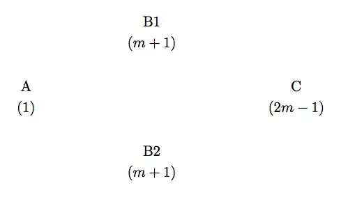

I've got this Tikz picture and I'd like to increase the horizontal distance between the nodes while keeping the vertical distance unchanged. I know how to do it by placing the nodes manually using coordinates, but I'd rather not do it if it can be avoided.
picture showing the nodes
Here's the code:
\documentclass{article}
\usepackage{tikz}
\begin{document}
\begin{tikzpicture}
  [align=center,node distance=2cm]
  \node[label=above:A] (A)
       {(1)};
  \node[label=above:B1] (B1) [above right of=A]
       {($m+1$)};
  \node[label=above:B2] (B2) [below right of=A]
       {($m+1$)};
  \node[label=above:C] (C)  [below right of=B1]
       {($2m-1$)};
\end{tikzpicture}
\end{document}
Any help appreciated.

You can specify the relative x and y positions separately using the tikz library positioning
\usepackage{tikz}
\usetikzlibrary{positioning}
\begin{document}
\begin{tikzpicture}
  [align=center,node distance=2cm]  %< no need of this global node separation
       {(1)};
  \node[label=above:B1] (B1) [above right=0.7cm and 4cm of A]
       {($m+1$)};
  \node[label=above:B2] (B2) [below right=0.7cm and 4cm of A]
       {($m+1$)};
  \node[label=above:C] (C)  [below right=0.7cm and 4cm of B1]
       {($2m-1$)};
\end{tikzpicture}
\end{document}

As Harish mentioned, you can use the positioning library and adjust horizontal and vertical position.
Another way, allowing you to specify distances for horizontal and vertical distances, is to use matrices. With this you can set the row and column distances. The code, for you diagram, is
\documentclass[border=5pt]{standalone}
\usepackage{tikz}
\usetikzlibrary{matrix}
\begin{document}
\begin{tikzpicture}[align=center]
\matrix[matrix of nodes,row sep=0.5cm,column sep=2cm]{
&|[label=above:B1]| ($m+1$)&\\
|[label=above:A]| (1)&&|[label=above:C]| ($2m-1$)\\
&|[label=above:B2]| ($m+1$)&\\
\end{tikzpicture}
\end{document}
The result is
