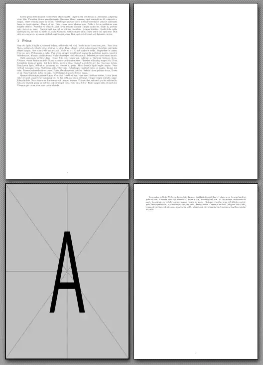

I can partially answer your question (I have a white page before the fullpage figure). In fact you define \newgeometry{margin=0cm}, put your figure, then \restoregeometry. The full code is:
\documentclass[a4paper,oneside]{article}
\usepackage{graphicx} \usepackage{lipsum,MWE} \usepackage[margin=2cm]{geometry}
\begin{document} \lipsum[1] \section{Prima} \lipsum[2-4] \newgeometry{margin=0cm} \thispagestyle{empty} \noindent \includegraphics[width=\textwidth,height=\textheight]{image-a} \restoregeometry \lipsum[6] \end{document}
The output:
