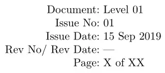

The horizontal alignment around the colon : is possible if you set the heading using a tabular:
\fancyhead[R]{%
  \footnotesize
  \begin{tabular}{@{} r @{:\ } l @{}}
            Document & Level 01    \\
            Issue No & 01          \\
          Issue Date & 15 Sep 2019 \\
    Rev No/ Rev Date & ---         \\
                Page & X of XX
  \end{tabular}}

  • Thanks. Request breakdown the following line. \begin{tabular}{@{} r @{:\ } l @{}} – js bibra Sep 17 '19 at 05:16

  • but now the header is misaligned --image above – js bibra Sep 17 '19 at 08:46
  • @jsbibra. Put both the Right and C header in their own tabular. That way they'll be vertically aligned in the centre. – Werner Sep 17 '19 at 15:55
  • The alignment is done using two columns in the tabular. The left column defined the "label" and the right the "value" associated with that label. You can change the alignment to be left, right or centre. The column separation is given by @{:\ } which prints a : followed by a space for each row. The outer @{} removes any column spacing, thereby pushing the tabular flush to the Right side of the page/header. – Werner Sep 17 '19 at 15:57
