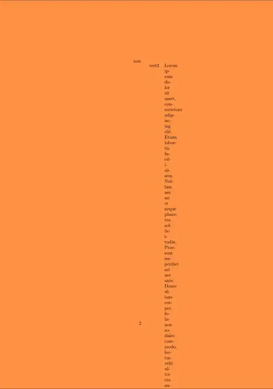

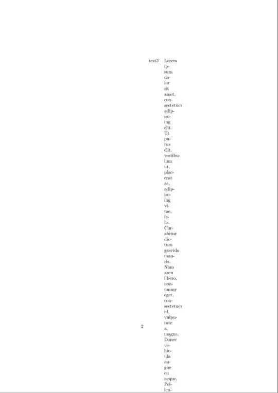

A typical page: enter image description here
The number of rows in the above example is not accidental: If we add a small number of additional copies of the row test & \innerTable{test2}{\blindtext[1]} \\ then the file will still compile, but the formatting breaks badly. In this case a typical page now looks like enter image description here Worse, this behavior is inconsistent across runs: Sometimes a file with 40 copies of the line will compile correctly, other times not.
Consulting the logfile shows the following warning:
Package tabularx Warning: X Columns too narrow (table too wide) (tabularx) on input line 79.
I know that the tabularx package (and so probably the ltablex package) tries to compute for each column of type X an appropriate width by some iterative process, so I suppose this warning means that the package gave up on trying to find a good width.

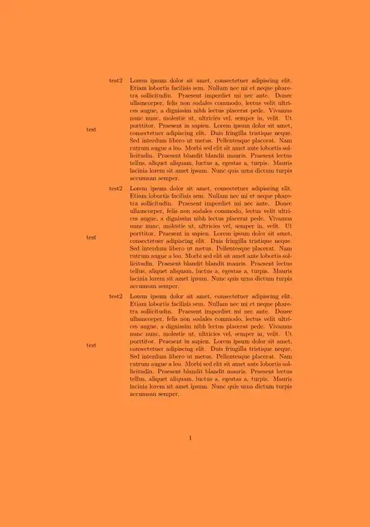

Edit. The tabularx package is not suited for use as nested tables in some other table. As some test show, it can be nested up to 45 time, than the calculation of X column width (in each nested tabularx doesn't work any more.
If this can be resolved is question for package authors.
Meanwhile this limitation can be avoided on two ways:
  • main table limit to 45 nested tabularx tables and than repeat main table (what seems to not be an option for OP)
  • instead tabularx use tabular* and manually in advance defined width of each columns in nested tables (which can require redefine of ratio between column width after inspection of result of the first compilation)
In both cases I would instead ltablex (which redefines abularx in lots of ways one is that, by default it turns X columns into l columns for small tables) rather use xltabular. For the second case, the solution can be:

enter image description here (red lines indicates page layout)
Addendum: You can elegantly avoid all problems by aligning of the cells' contents to their top. In this case, table nesting is no longer required, and the table record is shorter:

which gives (to my opinion, of course) nicer, more professional looking result:

  • Hey Zarko, thanks for the reply---I appreciate the help. This answer does not, however, seem to address the issue. The problem is not that the formatting breaks once the table extends onto a second page: In my post I mentioned that even with 40 rows (sometimes) the entire document renders correctly (and you can see from the screencap shows there only three rows are rendered per page). – Travis Sep 15 '19 at 19:16
  • The problem is that the formatting breaks once the table has larger row counts. If I modify your code (only) by changing the number of instances of test & \innerTable{test2}{\lipsum*[1]} \\ from 6 to 50 and compile, the formatting breaks in apparently the same way it does with the ltablex package: https://i.imgur.com/vHg1XQk.png . (I'll update my question to reflect this additional information.) If you have any more insight/suggestions, I'd be grateful to receive them. Thanks again! – Travis Sep 15 '19 at 19:22
  • Hi Zarko, thanks for spending time on this! Since the same number of repetitions sometimes works and sometimes does not, the outcome depends not only on the code but also the system state, which suggests a memory issue. Also, if you try my original code using the landscape option when loading the geometry package you'll find that the threshold beyond which the formatting issue occurs is closer to 20 rows, so the success of the code depends also in a substantial way on page geometry. – Travis Sep 15 '19 at 20:04
  • (But please do not look for a threshold yourself unless it is of independent interest to you: I would much rather keep a single table and use some alternative to achieve the desired effect, like writing a switch hardcoding in the width of the cell of the outer table according to whether the page format is letter or legal.) – Travis Sep 15 '19 at 20:06
  • Thank you for the addendum. The recommendation does not fit my needs, however. (If it did, I could have simply used \ltablex with a three-column table in the first place.) In my case, the entries of the left cells of the nested tables have variable length, so any solution needs to support output like here: https://i.imgur.com/TP9hL4S.png (This particular example is ugly, but in my actual use case the left cells of the nested tables are short and have just a handful of symbols, and the right cells have rather less text.) – Travis Sep 16 '19 at 05:40
