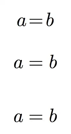

You can use \everymath and \everydisplay:
\documentclass{article}
\usepackage{amsmath}
\newmuskip\normalthickmuskip
\newmuskip\normalthinmuskip
\AtBeginDocument{%
  \normalthickmuskip=\thickmuskip
  \normalthinmuskip=\thinmuskip
\everymath{%
  \thickmuskip=\muexpr\normalthickmuskip-(1\normalthinmuskip plus 1\normalthinmuskip)\relax
\everydisplay{\thickmuskip=\normalthickmuskip}
\let\texdisplaystyle\displaystyle
\renewcommand{\displaystyle}{\texdisplaystyle\the\everydisplay}
\begin{document}
\begin{center} % just for easing comparisons with below formulas
$a=b$
\end{center}
a=b
\begin{align*}
a&=b
\end{align*}
\end{document}
The redefinition of \displaystyle is necessary because amsmath environments don't generally evaluate \everydisplay.
This will affect all relations, not only =. You may possibly want to decrease also \medmuskip in inline formulas.
