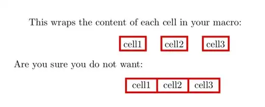

If you want to wrap a macro around each cell, you may be interested in collcell.
\documentclass[11pt]{article}
\usepackage{xcolor}
\usepackage{array}
\usepackage{collcell}
\usepackage{colortbl} % < for alternative
\begin{document}
\newcommand{\comm}[1]{
    \setlength{\fboxrule}{2pt}
    \fcolorbox{red}{white}{#1}
\newcolumntype{E}{>{\collectcell\comm}c<{\endcollectcell}}
This wraps the content of each cell in your macro:
\begin{center}
\begin{tabular}{*3{E}}
     cell1 & cell2 & cell3 \\
\end{tabular}
\end{center}
Are you sure you do not want:
\begin{center}
\setlength\arrayrulewidth{2pt}%
\arrayrulecolor{red}%
\begin{tabular}{|*3{c|}}
    \hline
     \hline
\end{tabular}
\end{center}
\end{document}
  • I was just about to post this as an answer. You're not citing me. :) But this approach will look awful as soon as you add more rows or if the cells are of unequal width and height. You might want to add an example of this to show the effect. – Alan Munn Jun 14 '19 at 06:09
  • @AlanMunn Yes, I agree that it won't look good but this is my interpretation of the OP's question and comments. (And yes, I should have started my answer with "As Alan Munn was going to point out, ...". ;-) –  Jun 14 '19 at 06:13
  • @marmot I prefer to use the first format rather than second(cells connected). – MRIDUL SHARMA Jun 14 '19 at 06:20
  • @MRIDULSHARMA You are free to use either of them, of course. –  Jun 14 '19 at 06:21
    @MRIDULSHARMA To be clear what we're talking about, try adding a row that contains the following: longCellone & cccc & cell3. Your cell heights and widths will all be different. – Alan Munn Jun 14 '19 at 06:22
