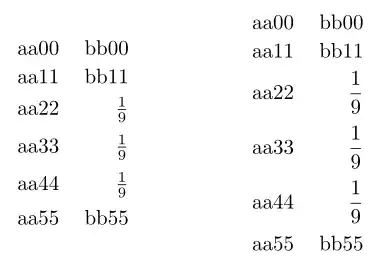

The simplest solution, in my opinion, uses the cellspace package, which enables you to define a minimal vertical padding at the top and bottom of cells in columns with specifier prefixed with the letter S (or C, if you load siunitx). Here is a demo:
\documentclass{report}
\usepackage{cellspace, amsmath}
\setlength{\cellspacetoplimit}{3pt}
\setlength{\cellspacebottomlimit}{3pt}
\begin{document}
\begin{table}[h!]
  \centering
   \begin{tabular}{l Sr }
    aa00 & bb00 \\
    aa11 & bb11 \\
    aa22 & $\frac{1}{9}$ \\
    aa33 & $\frac{1}{9}$ \\
    aa44 & $\frac{1}{9}$ \\
    aa55 & bb55
  \end{tabular}
\hspace{4em}
    aa00 & bb00 \\
    aa11 & bb11 \\
    aa22 & $\dfrac{1}{9}$ \\
    aa33 & $\dfrac{1}{9}$ \\
    aa44 & $\dfrac{1}{9}$ \\
    aa55 & bb55
  \end{tabular}
\end{table}
\end{document}
Bernard
  • 271,350

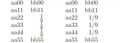

Inline-fraction notation was invented for a very good (typographic) reason: to display simple fraction expressions without needing to increase the row spacing. So, do consider switching from \frac notation to inline-fraction notation. The table on the right use 1/9 instead of \frac{1}{9}.
\begin{document}
\begin{table}[h!]
  \begin{tabular}{l r }
    aa00                  & bb00                \\
    aa11                  & bb11                \\
    aa55                  & bb55
  \end{tabular}
\qquad
    aa00                  & bb00        \\
    aa11                  & bb11        \\
    aa22                  & $1/9$       \\
    aa33                  & $1/9$       \\
    aa44                  & $1/9$       \\
    aa55                  & bb55
  \end{tabular}
\end{table}
\end{document}
Mico
  • 506,678
