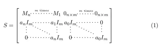

Another alternative option could be using the nicematrix package. You always get the same image as the very good user @marmot but here there is a short code; the dots are slightly spaced from the elements of the matrix. With a zoom between the two images you can see the difference between two images.
\documentclass{article}
\usepackage{nicematrix}
\begin{document}
\[S=\left[\begin{NiceArray}{CCCCCC}
M_n & \overset{\scriptstyle m \text{ times}}{\Cdots} & M_1&\!\!\!  0_{n\times m}&\overset{\scriptstyle m \text{ times}}{\Cdots} &0_{n\times m}\\
a_nI_m & \Cdots & a_1I_m&\!\!\!  a_0I_m&\Cdots &  0\\
\Vdots & \Ddots &  \Vdots &\!\!\!     \Vdots        &    \Ddots     & \Vdots\\
0 & \Cdots & a_nI_m        & 0&\Cdots &a_0I_m\\
\end{NiceArray}\right]
\end{document}

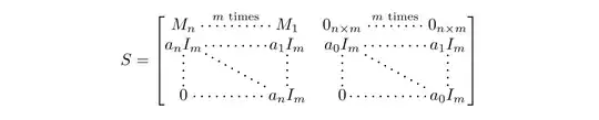

as supplement to @Sebastiano's answer (+1) ... with use of the bNiceMatrix instead of NiceArray and adding $m$ times in tikzpicture:
\documentclass[margin=3mm, preview]{standalone}
\usetikzlibrary{quotes} % for labels "m times"
\begin{document}
S = \begin{bNiceMatrix}[columns-width=2em, name=m]
M_n     & \Cdots & M_1     & 0_{n\times m} & \Cdots & 0_{n\times m} \\
a_nI_m  & \Cdots & a_1I_m  & a_0I_m        & \Cdots & a_1I_m        \\
\Vdots  & \Ddots & \Vdots  & \Vdots        & \Ddots & \Vdots        \\
0       & \Cdots & a_nI_m  & 0             & \Cdots & a_0I_m        \\
\end{bNiceMatrix}
\tikz[remember picture,overlay,font=\tiny]
\path   (m-1-1) to ["$m$ times"] (m-1-3)
        (m-1-4) to ["$m$ times"] (m-1-6);
\end{document}
note: for final result you need to compile above mwe at least twice.
Zarko

With the latest version of nicematrix (3.15, 20/04/06), it's possible to give a shorter version of Zarko's answer. Indeed with this version, it's possible to put labels on the dotted lines with ^ and _.
\begin{document}
S = \begin{bNiceMatrix}[columns-width=2em]
M_n     & \Cdots^{m \text{ times}} & M_1     & 0_{n\times m} & \Cdots^{m \text{ times}} & 0_{n\times m} \\
\end{bNiceMatrix}
\end{document}
Result of the above code
F. Pantigny
  • 40,250
