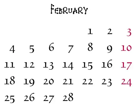

The above worked because lowercase figures are the default in SchneidlerMedSC-Med.otf. But it’s not clear how to procede when lowercase figures exist in but are not the default of the donor font. Here, for instance, is a deliberately tasteless attempt to combine Punk Nova with Neo Euler:
\documentclass{standalone}
\usepackage{combofont,tikz}
\usetikzlibrary{calendar}
\setupcombofont{punk-regular}
  {file:punknova-regular.otf:\combodefaultfeat} at #1pt,
  {file:euler.otf:+onum} at #1pt
   0x30-0x39
\DeclareFontFamily{TU}{punk}{}
\DeclareFontShape{TU}{punk}{m}{n}{<->combo*punk-regular}{}
\renewcommand{\rmdefault}{punk}
\begin{document}
\tikz\calendar[dates=2019-02-01 to 2019-02-last,
               week list,month label above centered]
               if (Sunday) [purple];
\end{document}
output of second example
I’d have expected +onum to produce Neo Euler’s lowercase figures, but it didn’t. By playing with the luaotfload manual, I found this solution (there may be better ones):
\def\feats{mode=base;+kern;+onum}
  {file:euler.otf:\feats} at #1pt
   0x30-0x39
\begin{document}
\end{document}
output of third example
