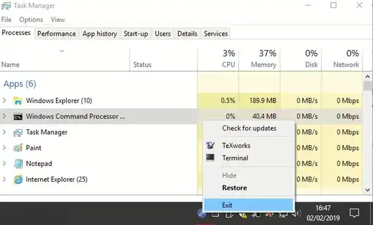

When launching MiKTeX-console via a .bat / .cmd file or shortcut it will usually show as an icon, however if you don't have show all icons it may not be visible.
You may need to expand all icons to locate it in the taskbar then you should be able to right click and control it. That is preferable rather than using > to expand the Windows Command Processor and killing it there.
