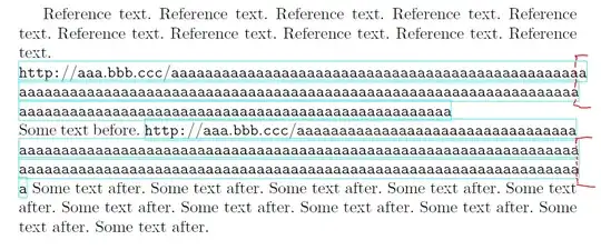

I'm struggling with hyphenation of long URLs (using command \url{}).
Line breaking works fine in cases when URL is just part of line which doesn't fit to text area width. That means URL is hyphenated correctly if line starts with some text before URL - or if hyphenated URL is followed by other text which is also hyphenated.
Problem is in parts of URL which are at the line alone
  1. first line of very long URL
  2. middle lines of very long hyphenated URL
At screenshot there is visible that both cases overflowed the text area - case 1 is clearly visible, but also case 2 overflowed by few pixels.
In real document overflowed area is variable depending on contents which makes sometimes collisions with objects on the right side (images, ...).
How to hyphenate URLs correctly to avoid such overflows?
  • ideal solution is perfectly aligned block
  • but acceptable is also solution with underflowed line instead of overflowed (earlier line break instead of late)
I guess problem is mainly caused by non-proportional font and is fixed if other proportional text is present at the same line, but how to handle alone parts of long URLs?

    I have retagged your question, since XeLaTeX and MikTeX are not really responsible for this issue. I have also added a much shorter MWE that still reproduces the issue, but gets rid of unnecessary packages. – moewe Dec 23 '18 at 09:47
Just add the call of package xurl before package hyperref.

gives you:
I will inform the maintainer of xurl about this bug. Meanwhile you can use the following (not perfect, but better than nothing ...) code ( I corrected the code in \def: \def\UrlBreaks{\do\a}):

url's are not hyphenated. They are broken. As they are actually set in math the parts are blocks of quite fix width, this makes it sometimes difficult to fill up a line. You can add a bit stretchability after the a to avoid the problem:

Ulrike Fischer
  • 327,261
    This seems to be the same issue as https://tex.stackexchange.com/q/466114/35864. I'm wondering if it would make sense to add that tiny bit of stretchable space to the biblatex definitions, since the result with one letter overflowing into the margin is visually unpleasant and also quite unintuitive when one looks at it for the first time: At least I would have thought that moving the protruding a into the next line would not have left the first line terribly underfull... – moewe Dec 23 '18 at 09:51
    @moewe yes. probably it would be a good idea to add it. In older times when file, folder and url names were rather short the stretchable space \Urlmedskip after the slash was enough but now it often leads to problems that there is not more in other places. – Ulrike Fischer Dec 23 '18 at 11:20
    Thanks you for the comment. have opened https://github.com/plk/biblatex/issues/850 so I don't forger about it over the holidays. – moewe Dec 23 '18 at 11:39
  • I've tried suggested solution and initially everything was perfect. But I wasn't happy for long time :-) After I'd replaced the dummy URL with the real, document couldn't be even compiled - Number too big error. I've updated the initial question with more information. – Joseph Dec 23 '18 at 14:43
    There was a \relax missing after the penalty number, and so it picked up the number in the url. – Ulrike Fischer Dec 23 '18 at 14:52
