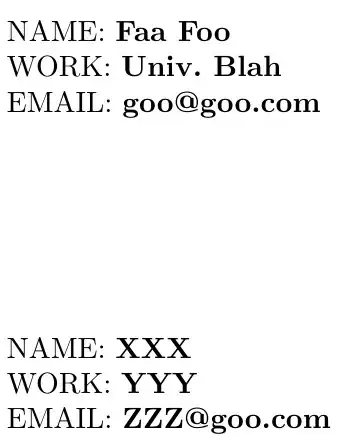

I have made it so that \@name[<index>] \@work[<index>], and \@email[<index>] are arrays, where the index is stepped with every call to \information{}{}{}.
\listcontact{<index>} will provide the contact info for the one specified index. In the MWE, I loop through all indices.
\documentclass{article}
\usepackage{pgffor}
\makeatletter
\newcounter{infocnt}
\newcommand{\name}[1]{%
  \expandafter\def\csname @name[\theinfocnt]\endcsname{#1}}
\newcommand{\work}[1]{%
  \expandafter\def\csname @work[\theinfocnt]\endcsname{#1}}
\newcommand{\email}[1]{%
  \expandafter\def\csname @email[\theinfocnt]\endcsname{#1}}
\newcommand{\information}[3]{%
  \stepcounter{infocnt}%
  \name{#1}%
  \work{#2}%
  \email{#3}%
\newcommand\listcontact[1]{\noindent%
  NAME: \textbf{\csname @name[#1]\endcsname}\\
  WORK: \textbf{\csname @work[#1]\endcsname}\\
  EMAIL: \textbf{\csname @email[#1]\endcsname}\par
  \vskip 1in
\makeatother
\information{Faa Foo}{Univ.\ Blah}{goo@goo.com}
\information{XXX}{YYY}{ZZZ@goo.com}
\begin{document}
\foreach\x in {1,2,...,\theinfocnt}{\listcontact{\x}}
\end{document}

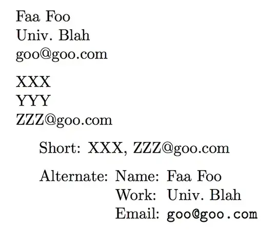

This is “property lists” playground. Here I define \newcontact for defining a contact with a key-value interface.
With \newcontactscheme one defines different ways to print the data; default is used by \listcontact if no optional argument is supplied. In the definition, use \getcontact{<key>}{#1} to print the value corresponding to <key> for the current contact, represented by #1.
\usepackage{xparse}
\ExplSyntaxOn
\NewDocumentCommand{\newcontact}{mm}
 {% #1 = contact label, #2 = data
  \prop_new:c { g_sigur_contact_#1_prop }
  \prop_gset_from_keyval:cn { g_sigur_contact_#1_prop } { #2 }
\NewDocumentCommand{\listcontact}{O{default}m}
  \cs_set_eq:Nc \__sigur_contact_list:n { sigur_contact_list_#1:n }
  \__sigur_contact_list:n { #2 }
\NewDocumentCommand{\getcontact}{mm}
  \sigur_contact_print:nn { #1 } { #2 }
\NewDocumentCommand{\newcontactscheme}{m+m}
 {% #1 = scheme name, #2 = definition
  \cs_new_protected:cn { sigur_contact_list_#1:n } { #2 }
\cs_new_protected:Nn \sigur_contact_print:nn
  \prop_item:cn { g_sigur_contact_#2_prop } { #1 }
\ExplSyntaxOff
\newcontactscheme{default}{%
  \par\noindent
  \getcontact{name}{#1}\\
  \getcontact{work}{#1}\\
  \getcontact{email}{#1}\par
\newcontactscheme{short}{%
  \getcontact{name}{#1}, \getcontact{email}{#1}%
\newcontactscheme{alternate}{%
  \begin{tabular}[t]{@{}l@{ }l@{}}
  Name:  & \getcontact{name}{#1} \\
  Work:  & \getcontact{work}{#1} \\
  Email: & \texttt{\getcontact{email}{#1}}
  \end{tabular}%
\newcontact{foo}{
  name=Faa Foo,
  work=Univ.\ Blah,
  email=goo@goo.com
\newcontact{xxx}{
  name=XXX,
  work=YYY,
  email=ZZZ@goo.com
\begin{document}
\listcontact{foo}
\medskip
\listcontact{xxx}
\medskip
Short: \listcontact[short]{xxx}
\medskip
Alternate: \listcontact[alternate]{foo}
\end{document}
A version that also defines \listallcontacts (the optional argument is one of the defined schemes).

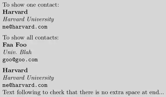

This is similar to Steven Seglets solution with slightly different packaging. You can show a single contact with \ShowContact{} or list all the contact with \listcontacts
Notes:
  • The values are stored based on #1 which is used as the key to access the contacts. An attempt to reuse the same key is now flagged as an error.
  • This has now been updated to add a \medskip between entries when the entire list is printed. The \medskip is not added before the first entry, nor after the last as shown in the figure.

  • Interesting. In this case, the contacts are accessed via argument value, not via a number, right? – Sigur Nov 15 '18 at 18:28
  • @Sigur: Yes, the first parameter is used as the key to access the information. This is really helpful if you have a large number of contacts. – Peter Grill Nov 15 '18 at 18:30
  • Since I'm going to share this file, do you know if etoolbox comes with a basic installation? Because I know that tikz does not. – Sigur Nov 15 '18 at 18:30
  • Yes, etoolbox is in the standard distribution. But, so is tikz so not sure why you think otherwise. Also, have added error checking in the updated version. – Peter Grill Nov 15 '18 at 18:34
  • Oh, maybe I am wrong about tikz... it would be good. Since I don't use MikTeX... – Sigur Nov 15 '18 at 18:41
  • Don't know about MikTeX. But with TeX:Live those are standard. – Peter Grill Nov 15 '18 at 18:45
  • Do you know how to modify the format if the contact printed is the last one? I mean, I want to remove the vertical skip when inserting the last contact. – Sigur Nov 15 '18 at 22:10
  • @Sigur: Yeah I can do that. Easiest solution would be to move the \medskip to be before you print the first one. Is that an option? – Peter Grill Nov 15 '18 at 22:13
  • Hum, I can not have any space before it. Or do you think that we can first remove it and then move it, so before the 1st one no additional space is inserted. – Sigur Nov 15 '18 at 22:20
  • But in my case, it is more complicated since I am going to insert a symbol between, so the symbol can not be before the 1st neither after the last. – Sigur Nov 15 '18 at 22:21
    @Sigur: As requested, I have updated it inserts a \medskip only between entries. You can replace the \medskip with the symbol you desire. – Peter Grill Nov 16 '18 at 06:39
