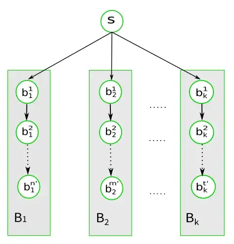

I am a new user to tikzplot. Does anyone know how to make the grey box with the nodes inside the box. Thanksenter image description here

EDIT:
\documentclass[border=5pt,tikz]{standalone}
\usetikzlibrary{fit,positioning,calc,arrows,backgrounds}
\tikzset{
    my/.style={
        draw=green,thick,fill=white,circle,minimum width=.5cm
    >=latex
\begin{document}
    \begin{tikzpicture}
        \node[my] (b11) {$b_1^1$};
        \node[below=1 of b11,my] (b12) {$b_2^1$};
        \node[below=1 of b12,my] (b1nprime) {$b_1^{n'}$};
        \node[below=1 of b1nprime] (B1) {$B_1$};
        \begin{pgfonlayer}{background}
            \node[draw=green,thick,fill=gray!40,fit=(b11)(B1)] {};
        \end{pgfonlayer}
        \draw[->] (b11) -- (b12);
        \draw[->,dotted] (b12) -- (b1nprime);
        \begin{scope}[xshift=3cm]
            \node[my] (b21) {$b_2^1$};
            \node[below=1 of b21,my] (b22) {$b_2^2$};
            \node[below=1 of b22,my] (b2mprime) {$b_2^{m'}$};
            \node[below=1 of b2mprime] (B2) {$B_2$};
            \node[draw=green,thick,fill=gray!40,fit=(b21)(B2)] {};
            \end{pgfonlayer}
            \draw[->] (b21) -- (b22);
            \draw[->,dotted] (b22) -- (b2mprime);
        \end{scope}
        \begin{scope}[xshift=6cm]
            \node[my] (bk1) {$b_k^1$};
            \node[below=1 of bk1,my] (bk2) {$b_k^2$};
            \node[below=1 of bk2,my] (bktprime) {$b_k^{t'}$};
            \node[below=1 of bktprime] (Bk) {$B_k$};
            \node[draw=green,thick,fill=gray!40,fit=(bk1)(Bk)] {};
            \end{pgfonlayer}
            \draw[->] (bk1) -- (bk2);
            \draw[->,dotted] (bk2) -- (bktprime);
        \end{scope}
        \foreach \x/\y in {b21/bk1,b22/bk2,b2mprime/bktprime}
            \node at ($(\x)!.5!(\y)$) {$\cdots$};
        \node[above=2 of b21,my] (s) {$S$};
        \foreach \x in {11,21,k1}
            \draw[->] (s) -- (b\x);
    \end{tikzpicture}
\end{document}
Here is the second output:
Screenshot
