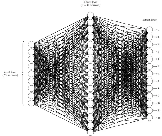

    \documentclass[border=5pt,tikz]{standalone}
    \usetikzlibrary{decorations.pathreplacing}
    \tikzset{
        neuron/.style={
            draw,circle,inner sep=.3cm,fill=white
        brace/.style={
            decorate,decoration={brace,amplitude=.3cm},thick
    \begin{document}
        \begin{tikzpicture}
            \foreach \x in {0,1,...,8}
                \node[neuron] (a\x) at (0,\x) {};
            \foreach \y in {-4,-3,...,12}
                \node[neuron] (b\y) at (8,\y) {};
            \foreach \z in {-2,-1,...,10}
                \node[neuron] (c\z) at (16,\z) {};
                \pgfmathsetmacro{\n}{10-\z}
                    \draw[->] (c\z) --+ (1,0) node[right] {\pgfmathprintnumber{\n}};
                \draw[->] (a\x) -- (b\y);
                \draw[->] (b\y) -- (c\z);
            \draw[brace] ([xshift=-1cm]a0.south) -- ([xshift=-1cm]a8.north) node[midway,text width=2.5cm,left=.5cm] {
                \begin{tabular}{c}
                    input layer \\
                    (784 neurons)
                \end{tabular}
            \node[above=1cm] at (b12) {
                \begin{tabular}{c}
                    hidden layer \\
                    ($n = 15$ neurons)
                \end{tabular}
            \node[above=1cm] at (c10) {
                \begin{tabular}{c}
                    output layer
                \end{tabular}
        \end{tikzpicture}
    \end{document}
with the following output:
Screenshot
I've got the following questions:
  • How can I achieve that I can enter the input arrays and the starting weights and the first code does the calculations (more precisely: how can I “extend“ the foreach loop so that the algorithm stops when the right resulst is achieved) and
  • How can I than highlight the weights visual e.g. I let TikZ draw two nodes (which represent neurons) and the more “important“ a bond is the line (which connects the two neurons) gets thicker (this all happens step for step, so that we can create a little animation)?
P.S.: The feedforward network doesn't need to have such a big amount of neurons, this is just an illustration.
