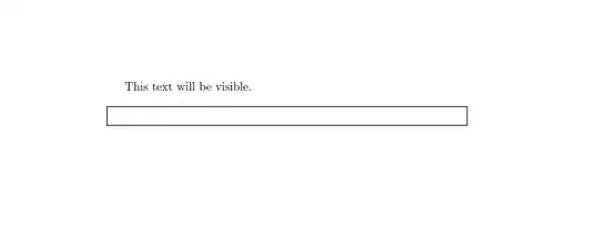

Ok, this has already been answered so I just want to contribute with the usage of the \phantom command.
\begin{document}
    This text will be visible. \\
    \phantom{This text will be invisible} \\
    \fbox{\phantom{This text will be invisible too, but a box will be printed arround it.}}
\end{document}
LaTeX output.
