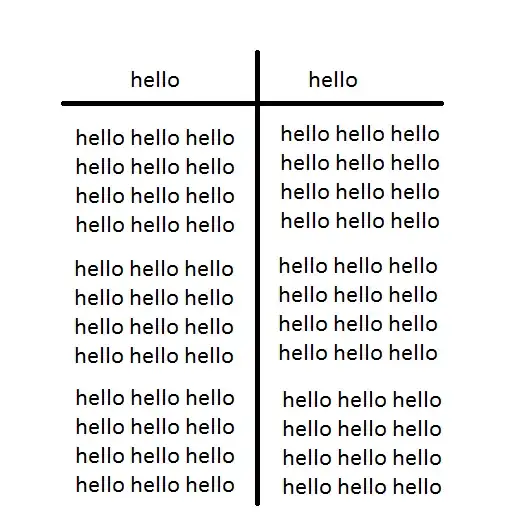

I want to create this table:
Enter image description here
I started with this, but it doesn't work:
How can I fix this?

    You cannot use vertical lines with booktabs horizontal rules. So you need to either replace \toprule with \hline or get rid of the vertical line. However \toprule is not the correct choice of rule, it should be \midrule but I expect what you're really going for is a thicker line, which demands a different solution https://tex.stackexchange.com/questions/256731/changing-width-of-table-lines – Au101 Aug 26 '18 at 16:46
    In terms of the too wide table cell, there are various solutions, the most basic of which would be to use something like p{2cm} (where 2cm is a fairly arbitrary length, you will have to select the width that you would like to use) instead of a c column. With c the column will be as wide as its contents, and if that means too wide for the page then unfortunately the table will run off the page, the line won't break, because you haven't told it when to break. With p{2cm} you tell it you want a 2cm wide cell and then the line will break to respect that – Au101 Aug 26 '18 at 16:48
    You can use \specialrule{\heavyrulewidth}{0pt}{0pt}: it will have the same thickness as \toprule but no vertical padding. An alternative: load boldline , from the shipunov bundle, which defines horizontal and vertical lines with custom thickness. – Bernard Aug 26 '18 at 16:53
Don't use booktabs with vertical rules.
And don't load packages twice (you have two \usepackage{graphicx}).
I have used tabularx, and \\[4pt] and \rule{0pt}{16pt} to add some space before and after the horizontal rule.

The screenshot that accompanies your query creates the impression that each table column should be just wide enough (but no wider) to typeset three instances of the word "hello", separated by whitespace. If this impression is correct, you should use the p column type for both columns. The p column type takes an argument -- the usable width. In the preamble, be sure to set up a length parameter and measure the width of "hello hello hello" via a \settowidth directive.
Oh, and don't use the booktabs package (and \midrule directives) if you employ vertical lines. Instead, use \hline.

like this:
beside tabularx are used options !{<option>} and \Xhline{<width>} from the package array (in this case loaded by the package tabularx) and macro \makecell from the package of the same name:

Since the rules are very thick, maybe you want to have the rounded caps as in the picture. It's possible to draw rules with rounded caps with Tikz. With the environment {NiceTabular} of nicematrix, you have PGF/Tikz nodes constructed under the row, columns and cells and it's easy to use them with Tikz to draw whatever rule you want.
