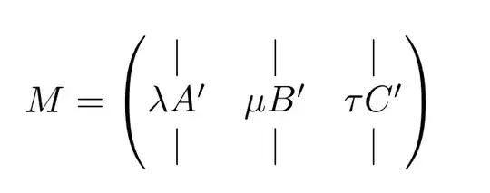

Can someone please tell me how I get vertical lines in the columns of a matrix like it is shown in the picture?
I started with ... = \begin{pmatrix} \lambda A' & \mu B' & \tau C' \end{pmatrix} ...

Use \mid as ordinary table entry.
\documentclass{article}
\usepackage{amsmath}
\begin{document}
\[ M =
  \begin{pmatrix}
    \mid & \mid & \mid \\
    \lambda A' & \mu B' & \tau C' \\
    \mid & \mid & \mid
  \end{pmatrix}
\end{document}

You could use a \vline
\begin{document}
$ M = \begin{pmatrix}
\vline & \vline & \vline \\
\end{pmatrix}$
