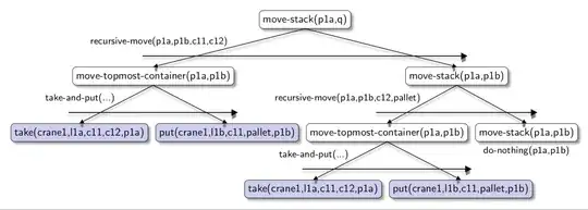

Does somebody help me to draw the following tree in TikZ (with different colors at leaves)? I have no idea how to draw particularly the horizontal line crossing the edges.
Thank you. Bestenter image description here
My code is here:

  • welcome to tex.ae! what you try so far? horizontal line is relative simple to add (just name nodes and draw them as \draw[->] ([yshift=...] <node name>) -- ..., but wrote your tree from scratch is not fun ..:-) – Zarko Jul 30 '18 at 10:01
To fill the background of a leaf, use \node [fill=<colour>] ... I made a style with that, so if you want to change the colour, just modify the style.
Zarko's suggestion for the arrows work fine, but you need to specify the anchor as well, so use e.g. \draw [->] ([yshift=3mm]p1.north) -- ([yshift=3mm]p2.north);. I used a \foreach loop to draw the arrows, which makes the code a bit shorter.
For the do-nothing, you can add a label to the node, i.e. \node [label={below:do-nothing(p1a,p1b)}] (p6){move-stack(p1a,p1b)};.

This is shamelessly based on Zarko's answer and is, basically, a more automated form of that solution, with slightly more flexible and streamlined code.
    parent anchor=children,
    child anchor=parent,
Where possible, my code uses anchors which are sensitive to the direction of the tree's growth. This is especially useful when specifying the code for the horizontal arrows, but good practice generally as it makes for greater flexibility.
  where n children=0{fill=blue!50!gray!25}{fill=white},
This saves having to apply the colour manually to each node which needs it. Since all those nodes are leaves and no leaves aren't coloured, it makes sense to use this feature to have Forest determine which ones to fill with blue and which with white.
  where={>O_={n}{1}}{tikz+={\draw [thick, shorten >=-10pt, shorten <=-10pt, -{Triangle[width=6pt,length=6pt]}] ([yshift=10pt].-children) -- ([yshift=10pt]!s.-children); }}{}
This code draws the horizontal arrows, without relying on the manual addition of name to each node. Every first child has a sibling and every such pair has an arrow above, but no other cases need arrows, so we use a node's being the first to decide whether or not to draw the arrow.
This specifies the path from 10pt above the anchor .-children of the current node to 10pt above the anchor .-children of its sibling (!s). Again, .-children depends on the direction of growth of three tree.
I've also used arrows from arrows.meta as arrows such as -stealth are considered deprecated and do not support the new, more flexible and consistent syntax.

solution with forest:
