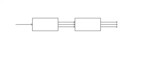

MWE:
\documentclass{scrartcl}
\usepackage{tikz}
\tikzset{
         signal/.style = coordinate,
         block/.style = {
                         draw,
                         rectangle,
                         minimum height = 2em,
                         minimum width = 4em
\usetikzlibrary{positioning}
\begin{document}
  \begin{tikzpicture}
    \node[signal] (input) {};
    \node[
          block,
          right = of input
         ] (block 1) {};
    \node[
          block,
          right = of block 1
         ] (block 2) {};
    \node[
          signal,
          right = of block 2
         ] (output) {};
    \draw
      [->] (input) -- (block 1);
    \draw
      [->] (block 1) -- (block 2);
    \draw
      [->] (block 2) -- (output);
  \end{tikzpicture}
\end{document}
Gives:
result
I wish (the lines and arrows shouldn't be bold):
wish
Is it possible to do this more or less automatically, without to draw each of the three lines by hand. Even the place of the three lines should be set automatically. That means: The middle line should placed on the vertical middle. The above and below lines should be symmetrically above and below the middle line.
Thank you for your help and effort in advance!
Su-47
  • 2,508

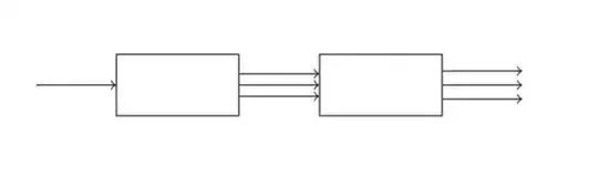

Something like this?
\usepackage{tikz}
\tikzset{
         block/.style = {
                         draw,
                         rectangle,
                         minimum width = 4em
\usetikzlibrary{decorations.markings,positioning}
\tikzset{triple line with arrows/.style args={#1,#2,#3}{decorate,decoration={markings,%
mark=at position 0 with {\coordinate (ta-base-1) at (0,4pt);
\coordinate (ta-base-2) at (0,0pt);
\coordinate (ta-base-3) at (0,-4pt);},
mark=at position 1 with {\draw[#1] (ta-base-1) -- (0,4pt);
\draw[#2] (ta-base-2) -- (0,0pt);
\draw[#3] (ta-base-3) -- (0,-4pt);}}}}
\begin{document}
  \begin{tikzpicture}
    \node[
          block,
          right = of input
         ] (block 1) {};
    \node[
          block,
          right = of block 1
         ] (block 2) {};
    \node[
          signal,
          right = of block 2
         ] (output) {};
    \draw
    \draw
      [triple line with arrows={->,->,->}] (block 1) -- (block 2);
    \draw
      [triple line with arrows={->,->,->}] (block 2) -- (output);
  \end{tikzpicture}
\end{document}
ADDENDUM: Just for fun: a slightly more flexible version.
\usepackage{tikz}
\tikzset{
         block/.style = {
                         draw,
                         rectangle,
                         minimum width = 4em
\pgfkeys{tikz/.cd,
         triple line distance/.store in =\triplelinedist,
         triple line distance=4pt
mark=at position 0 with {\coordinate (ta-base-1) at (0,\triplelinedist);
\coordinate (ta-base-3) at (0,-\triplelinedist);},
mark=at position 1 with {\draw[#1] (ta-base-1) -- (0,\triplelinedist);
\draw[#3] (ta-base-3) -- (0,-\triplelinedist);}}}}
\begin{document}
  \begin{tikzpicture}
    \node[
          block,
          right = of input
         ] (block 1) {};
    \node[
          block,
          right = of block 1
         ] (block 2) {};
    \node[
          signal,
          right = of block 2
         ] (output) {};
    \draw
    \draw
    \draw
      [triple line with arrows={->,->,->},triple line distance=5pt] (block 2) -- (output);
  \end{tikzpicture}
\end{document}
You can make use of the \foreach loop
\usepackage{tikz}
\tikzset{
         block/.style = {
                         draw,
                         rectangle,
                         minimum width = 4em
\begin{document}
  \begin{tikzpicture}
  \node[
        block,
        right = of input
       ] (block 1) {};
  \node[
        block,
        right = of block 1
       ] (block 2) {};
  \node[
        signal,
        right = of block 2
       ] (output) {};
  \draw
  \foreach \k in {-1,0,1}{
    \draw [->] ([yshift=\k*.2cm]block 1.east) -- ([yshift=\k*.2cm]block 2.west);
    \draw [->] ([yshift=\k*.2cm]block 2.east) -- ([yshift=\k*.2cm]output.west);
  \end{tikzpicture}
\end{document}
result
I am shifting the positions of the arrows up and down by a certain amount depending on the value of \k (-1, 0, and finally 1).

    \inheritanchor[from=rectangle]{base east}
    \inheritanchor[from=rectangle]{south}
    \inheritanchor[from=rectangle]{south west}
    \inheritanchor[from=rectangle]{south east}
    \savedmacro\blockinputs{%
        \pgfmathparse{int(\block@inputs)}%
        \let\blockinputs=\pgfmathresult}%
    \savedmacro\blockoutputs{%
        \pgfmathparse{int(\block@outputs)}%
        \let\blockoutputs=\pgfmathresult}%
    \savedmacro\blockmaxio{%
        \pgfmathparse{int(max(\block@inputs,\block@outputs))}%
        \let\blockmaxio=\pgfmathresult}%
    \savedmacro\blockflip{%
        \pgfmathparse{\@block@flipbool}%
        \let\blockflip=\pgfmathresult}%
    \saveddimen\halfwidth{\pgfmathsetlength\pgf@x{%
            \pgfkeysvalueof{/pgf/minimum width}/2}\pgfmathresult}
    \saveddimen\halfheight{\pgfmathsetlength\pgf@x{%
            \pgfkeysvalueof{/pgf/minimum height}/2}\pgfmathresult}
    \saveddimen\iospacing{\pgfmathsetlength\pgf@x{%
            \block@iospacing}\pgfmathresult}
    \inheritbackgroundpath[from={rectangle}]
    \pgfutil@g@addto@macro\pgf@sh@s@block{%
        \pgfmathloop%
        \ifnum\pgfmathcounter>\blockinputs\relax%
        \else%
        \pgfutil@ifundefined{pgf@anchor@block@input \pgfmathcounter}{%
            \expandafter\xdef\csname pgf@anchor@block@input %
            \pgfmathcounter\endcsname{\noexpand%
                \pgf@sh@lib@block@in@anchor{\pgfmathcounter}%
        \repeatpgfmathloop%
        \pgfmathloop%
        \ifnum\pgfmathcounter>\blockoutputs\relax%
        \else%
        \pgfutil@ifundefined{pgf@anchor@block@output \pgfmathcounter}{%
            \expandafter\xdef\csname pgf@anchor@block@output %
                \pgf@sh@lib@block@out@anchor{\pgfmathcounter}%
        \repeatpgfmathloop%
\def\pgf@sh@lib@block@in@anchor#1{%
    \pgf@process{\centerpoint}%
    \pgf@ya=\pgf@y%
    \ifnum\blockflip=0\relax%
        \pgf@process{\southwest}%
    \else%
        \pgf@process{\northeast}%
    \fi%
    \pgfmathsetlength\pgf@y{\pgf@ya + (0.5*(\blockinputs+1)-#1)*\iospacing}
\def\pgf@sh@lib@block@out@anchor#1{%
    \pgf@ya=\pgf@y%
    \else%
    \fi%
    \pgfmathsetlength\pgf@y{\pgf@ya + (0.5*(\blockoutputs+1)-#1)*\iospacing}
\makeatother
\begin{document}
    \begin{tikzpicture}
        \node[block={outputs=3}](node1){};
        \node[block={inputs=3,outputs=3},right=of node1](node2){};
        \draw[<-] (node1.input 1) -- ++(-1,0);
        \foreach \i in {1,...,3}{
            \draw[->] (node1.output \i) -- (node2.input \i);
            \draw[->] (node2.output \i) --++(1,0);
    \end{tikzpicture}
\end{document}
