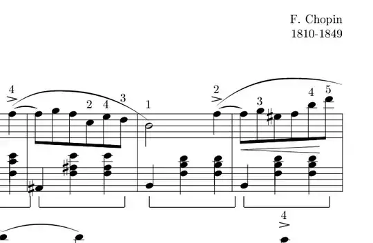

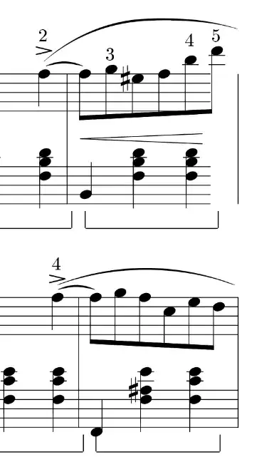

I have an issue with some bars at end of line (see image). As you can see on the second line, it not happens at every lines.
Do you have any idea why does this happens ? (part of the code below)
Thanks,
LoloDf

  • Welcome to TeX.SE. I love music, but is there \endpiece or \Endpiece at the end after \startpiece? – Sebastiano Jul 05 '18 at 10:36
  • Hello, it's an \Endpiece, the whole code was too long to put here :) I'll edit adding more details – LoloDf Jul 05 '18 at 10:39
  • You are welcome always here. Positive vote for entering the full code and for the effort made. – Sebastiano Jul 05 '18 at 10:58
    There is a curious fact: if I remove the [HERE...] part and comment out the call to geometry, the sequence pdflatex-musixflx-pdflatex produces very bad output. This makes me think there's an input error somewhere. – egreg Jul 05 '18 at 11:00
  • What do you mean by bad output ? can you show the output ? (I don't have latex on the laptop I use right know...maybe the bad output is due to the cut I made in the code...) – LoloDf Jul 05 '18 at 11:41
  • And why commenting geometry ? – LoloDf Jul 05 '18 at 12:59
The user's guide declares it's important to handle blank lines within the input files.
Here, however, you should keep a blank before your beginning of the input.
