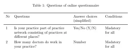

I'd suggest the following redesign of your table: Is it des not make much sense, to have four equally wide columns (especially not regarding the contents of the first and second column), I have used an l type column for the first column. Additionally, I have added the l option to all X columns in order to allow for a raggedright alignment in them. I have also added some multipliers (2) and (0.75). In order to make the second column wider. Lastly, I have added the \tabulinesep in order to adjust the spacing:
\documentclass{article}
\usepackage{longtable}
\usepackage{tabu}
\usepackage{booktabs}
\setlength{\tabulinesep}{3pt}
\begin{document}
\begin{longtabu} to \textwidth {lX[2 l]X[l]X[0.75 l]}
\caption{Questions of online questionnaire}\\
\toprule
Nr & Questions & Answer choices (simplified) & Conditions\\
 \midrule
1     & Is your practice part of practice network consisting of practices at different places? & Yes/No (Y/N) & Madatory for all \\
2     & How many doctors do work in your practice? & Number & Madatory for all \\
\end{longtabu}
\end{document}
