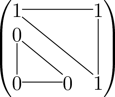

How could I draw with LaTeX such a matrix?
I've looked around but didn't find any solution.

Doing the matrix with amsmath's pmatrix and the lines with tikz and tikzmark:

Or, greatly simplified by Mr. marmot:

Alternative to Phelype's nice answer with a bit less labeling and computations: draw the whole thing in TikZ.

Here is a solution with {pNiceMatrix} of nicematrix. You switch very easily between the (continuous) dotted lines and the solid lines.

You need several compilations (because nicematrix uses PGF/Tikz under the hood).
Output of the above code

Another simple solution, with pstricks:

A solution with just tikz (no kind of matrix)... I just adding the solution to show some nice ideas about scaling tikzpictures and taking in account the font:
Play with the value of \mscale to see what I mean:
