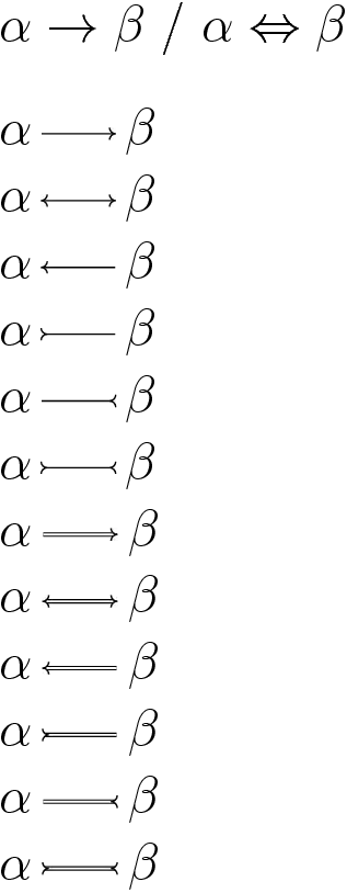

\documentclass{article}
\usepackage{amsmath}
\usepackage{tikz,xparse,xstring}
\usetikzlibrary{calc}
\newcommand{\MyArc}[1][1]{%
    \begin{scope}[#1]
        \fill[white]
            (0,0) arc (270:180:4*\ArW) -- (0,4*\ArW) -- cycle ;
        \draw   (0,0) arc (270:180:4*\ArW) ;
        \fill[white]
            (0,0) arc (90:180:4*\ArW) -- (0,-4*\ArW) -- cycle ;
        \draw (0,0) arc (90:180:4*\ArW) ;
    \end{scope}
\newcommand{\MyArcRv}[1][1]{%
    \begin{scope}[#1]
        \fill[white] (0,4*\ArW) arc (0:-90:4*\ArW)
            arc (90:0:4*\ArW) -- cycle ;
        \draw (0,4*\ArW) arc (0:-90:4*\ArW)
            arc (90:0:4*\ArW) ;
    \end{scope}
\tikzset{%
    Arrow width/.store in=\ArW,
    Arrow width=.5pt,
    pics/.cd,
    arc east/.style={code = {\MyArc[xshift=.5*\pgflinewidth]}},
    arc west/.style={code = {\MyArc[rotate=180,xshift=.5*\pgflinewidth]}},
    arc rv east/.style={code = {\MyArcRv[xshift=.5*\pgflinewidth]}},
    arc rv west/.style={code = {\MyArcRv[rotate=180,xshift=.5*\pgflinewidth]}}
\NewDocumentCommand{\imparrow}{
    D<>{} % above
    O{1.4em} %length
    m % pattern
    D<>{} % below
    \def\Law{}
    \def\Raw{}
    \def\Style{}
    \IfBeginWith{#3}{<}{\def\Law{pic{arc west}}}{}
    \IfBeginWith{#3}{>}{\def\Law{pic{arc rv west}}}{}
    \IfEndWith{#3}{>}{\def\Raw{pic{arc east}}}{}
    \IfEndWith{#3}{<}{\def\Raw{pic{arc rv east}}}{}
    \IfSubStr[1]{#3}{=}{\def\Style{double}}{}
    \tikz [baseline=-.5ex,line width=.4pt]
        \draw[\Style] (-3pt,0) (0,0) \Law
            -- node[below=-2pt] {#1} node[above=-2pt] {#4}
            (#2,0) \Raw
            ++(3pt,0);}
\begin{document}
\LARGE
$\alpha\to\beta$ / $\alpha\Leftrightarrow\beta$\bigskip
$\alpha \imparrow{->} \beta$
$\alpha \imparrow{<->} \beta$
$\alpha \imparrow{<-} \beta$
$\alpha \imparrow{>-} \beta$
$\alpha \imparrow{-<} \beta$
$\alpha \imparrow{>-<} \beta$
$\alpha \imparrow{=>} \beta$
$\alpha \imparrow{<=>} \beta$
$\alpha \imparrow{<=} \beta$
$\alpha \imparrow{>=} \beta$
$\alpha \imparrow{=<} \beta$
$\alpha \imparrow{>=<} \beta$
\end{document}
Tarass
  • 16,912
  • This looks great. Do you happen to know how to make these scalable so that it could be used as subscript or superscript by having it size automatically reduced? – J Marcos Mar 29 '18 at 12:24
