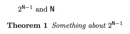

It may happen that the choice of a different font set doesn't update \mathtt. The solution is simple and the advantage over other solutions involving \text is that this can be easily adapted to support \boldmath out of the box.
\documentclass{article}
\usepackage[T1]{fontenc} % necessary for beramono
\usepackage{amsmath}
\usepackage{beramono}
% update \mathtt to use the same font as \ttfamily
\DeclareMathAlphabet{\mathtt}{\encodingdefault}{\ttdefault}{m}{n}
% if the monospaced font also supports boldface (b or bx)
\SetMathAlphabet{\mathtt}{\encodingdefault}{\ttdefault}{b}{n}
\newtheorem{theorem}{Theorem}
\begin{document}
$2^{\mathtt{N}-1}$ and \texttt{N}
\begin{theorem}
Something about $2^{\mathtt{N}-1}$
\end{theorem}
\end{document}
