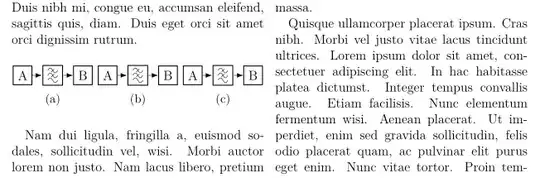

I have the following two-column article, where I am resizing 3 TikZ figures inside subfigures as to fit them in a single column (code below).
I want all the text in the TikZ figures (in this specific case, the As and Bs inside the squares) to match the font size of the document (that is, the TikZ font size to be equal to the Lorem ipsum font size).
How can I ensure this after resizing?
How can the text in a TikZ figure be forced to match the text size of a document?

instead of images you need to reduce nodes size and distance between them. node from circuitikz should be scaled. appropriate scale factor i found by "trial and error". in mwe below also the code for images is slightly simplified.

note:
your problem arise from mixing elements from two different packages: tikzpicture and tikz which has different approach to scaling their elements (as far as i know). so you have three possibilities to managed your problem:
  • use solution showed above
  • use image in its natural size and put each sub images in own line
  • span figure float over both column, i.e. instead {figure} use {figure*}. however it can be placed only on the top of the next page or in the case, that you employ package stfloats on the bottom of the same page, where it is inserted.
of course, you can stick with your method and accept the fact that with use of \resizebox font size shrink too.
Zarko
  • 296,517
    Isn't it possible to scale the figure directly leaving the font size anchored? – jlnkls Feb 04 '18 at 17:14
  • @tli, try this, but before read comments below your question. – Zarko Feb 04 '18 at 17:15
  • What you propose is a good solution, the problem is that I am looking for a more general method where no matter what text in a tikz picture, its size is anchored and everything else is scaled – jlnkls Feb 04 '18 at 17:59
  • @tli, well then don't scale your images at all. use them as they have natural size, for example in your case as three subimages each below other, or span figure over both column of text. there is not general method to put elephant into suitcase :-) (for this some wizardry had to be employed ...). or stick with your method and accept the fact that in this case font size shrink too. – Zarko Feb 04 '18 at 18:10
  • Okay, let's say that I want an image to span half of the column width of a document, but then want the TikZ font size to be equal to the text font size. Then, since the nodes stay as big as they were before, I would like the nodes and distances to be re-adjusted automatically. Isn't there a way to do this programatically instead of by "trial and error"? Otherwise, your solution is great – jlnkls Feb 04 '18 at 21:00
