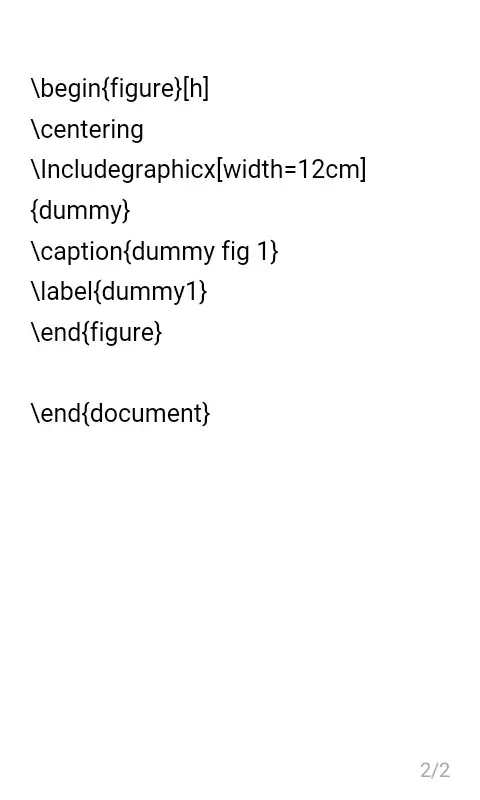

  • There are my codes – Leinah Jan 09 '18 at 06:39
