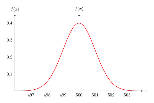

My problem: Try to produce two different plots
  1. First plot the y-axis should intersect the x-axis at 496, thus on the left side and the label should be on top of the y-axis (picture)
  2. Second plot the y-axis should intersect the x-axis at its middle (500) and the label should be on top

  • You need both plots in the same tikzpicture or in separate ones? if in the same, it reduces the problem just to plot an extra y-axis in your original plot, right? – Cragfelt Dec 18 '17 at 10:17
Your question is not clear in what you want, whether both plots in the same tikzpicture (coordinate system) or in separate ones.
Anyways, if in the same, it reduces the problem just to plot an extra y-axis in your original plot.
I am posting both alternatives:

if i understand you correctly, than you looking for:
code for above image is based on my answer to your previous question:
