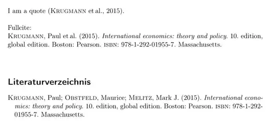

you will get the result:

you get the result:
resulting pdf

  • Thank you very much. Now the dot is there :-) Do you have any suggestions for the delimiters and the "&"? – user2894356 Nov 07 '17 at 20:12
  • It is as you want with latest biblatex (as you can see from the screenshot) – at least it should be since I could not test with the corresponding version of biber (not out yet), only with bibtex8. – Bernard Nov 07 '17 at 20:21
  • Sorry, you misunderstood me. Up to three authors I would like not have the "et al.". So in this case the fullcite should really look 1:1 like in the bibliography. – user2894356 Nov 07 '17 at 20:35
  • Do you mean that for three authors ase here, you cite the first two, without et al.? – Bernard Nov 07 '17 at 20:39
  • The command \fullcite should produce: Krugmann, Paul; Obstfeld, Maurice; Melitz, Mark J. (2015). International... So if Krugmann et al. would be written from 4 authors, then it should look like you made it with the et al. :-) – user2894356 Nov 07 '17 at 20:50
  • I was going to say ‘use maxcitenames=3, but I see that in this case we don't have anymore semicolons, but commas. I'll try to see for a solution. – Bernard Nov 07 '17 at 20:54
