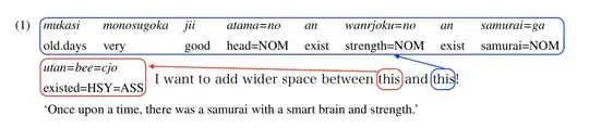

I am using gb4e.sty to provide inter-linear language glossing. This works well, but I want to get wider spacing between lines when sentences have 2 or more lines like this; screenshot_gb4e
Here is my source code:

\gll mukasi monosugoka jii atama=no an wanrjoku=no an samurai=ga utan=bee=cjo\\
old.days very good head=NOM exist strength=NOM exist samurai=NOM existed=HSY=ASS\\
\trans `Once upon a time, there was a samurai with a smart brain and strength.'

You can redefine \eachwordtwo to include more space. If that leaves too much space between the free translation and the gloss line, you can redefine \trans to have a small negative \vspace{}. If you have three line glosses, you need to redefine \eachwordthree.
I've made some corrections to your document: the times package is deprecated, and you shouldn't use it. Instead use newtxtext and newtxmath. Also, two letter font changing commands are also deprecated, and you should use their proper replacements (in this case \itshape).

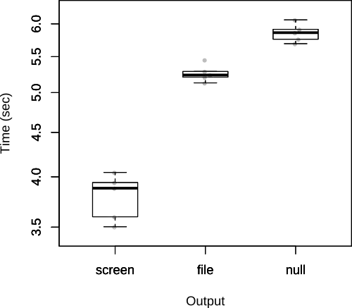

output of code
Alan Munn
  • 218,180
  • Could you please explain why \rule[-10pt] has this effect? I don't understand how the tweak works. – Vincent Krebs Jan 17 '23 at 20:57
    @VincentKrebs The \rule macro takes 2 obligatory arguments (a width and a height) and an optional depth argument (relative to the baseline). When the depth argument is negative that has the effect of lowering the rule below the baseline. So in this case we can add more space by adding a negative depth rule with zero height and zero width. – Alan Munn Jan 17 '23 at 21:48
